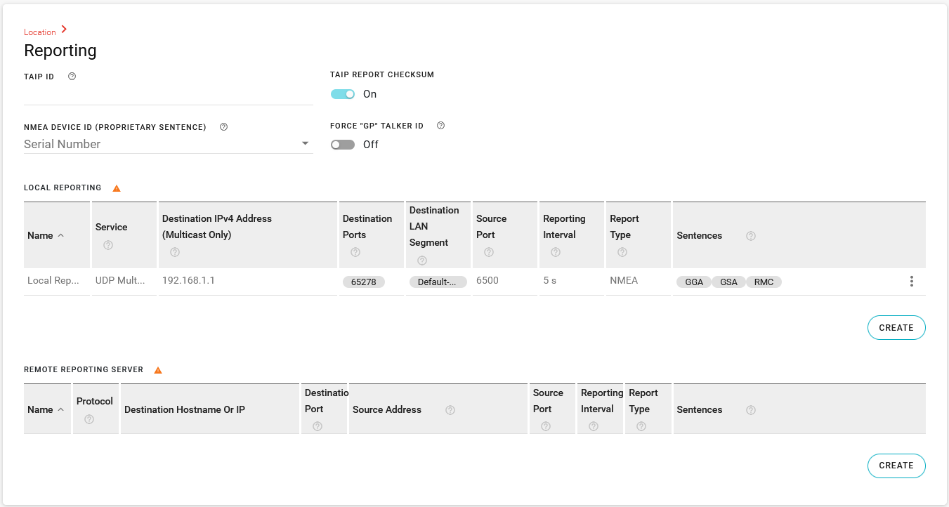

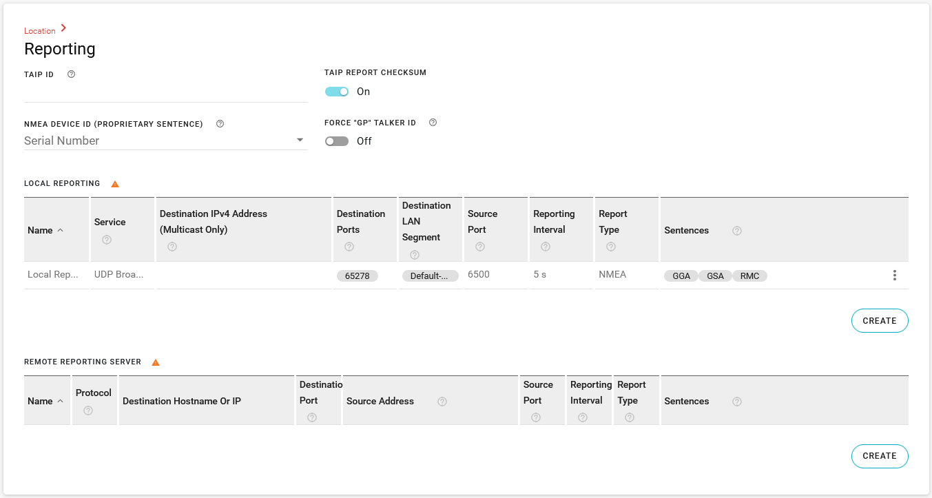

    Local Reporting
    Local reports are sent via UDP to an IP address on the LAN.
    Local Reporting broadcasts unencrypted NMEA sentences over UDP that can be intercepted by unintended recipients. Semtech recommends routing NMEA traffic through a VPN. See Configuring VPN.
    To configure Local Reporting:
    1. Click CREATE below the LOCAL REPORTING table.
    2. In the Create Local Reporting window, configure the following settings:
    SETTING DESCRIPTION RANGE DEFAULT
    NAME Enter a name for the report. n/a n/a
    SERVICE The protocol over which reporting traffic is sent. UDP Broadcast sends traffic to a subnet, while UDP Multicast sends traffic to a LAN or another network. When UDP Multicast is selected, you must enter a Destination IPv4 address. UDP Broadcast or UDP Multicast UDP Broadcast
    DESTINATION IPV4 ADDRESS (MULTICAST ONLY) This setting is available when UDP Multicast service is selected. To send the location report(s) to a local LAN client, enter the address here. If there is more than one local client, it is advisable to set up a DHCP reservation or set a static IP address on the client. n/a n/a
    DESTINATION PORTS Enter the port(s) on which the CAD/AVL application is configured to receive data. The port number(s) should be available from your CAD/AVL administrator or application documentation. 1–65535 65278
    DESTINATION LAN SEGMENT
    Enter the LAN segment for multiple clients. If you have multiple clients that require the location reports, you can send reports to each client on a particular LAN segment.
    If you need to send reports to multiple LAN segments, each LAN segment needs to be included in a separate Local Report.
    n/a n/a
    SOURCE PORT If you require the ability to control the UDP source port for sending local location reports, enter a port number. In some cases, the SOURCE PORT and DESTINATION PORT may need to match. The setting is blank by default. If blank, the router selects a random source port. 1–65535 Blank
    REPORTING INTERVAL Sets how frequently the location report is sent to the LAN or IPv4 destination. 1–100000 seconds 5
    REPORT TYPE
    Select the report type (or protocol, as described above).
    • NMEA
    • TAIP PV report: TAIP location report that contains PV (Position/Velocity Solution) messages
    • TAIP CP report: TAIP location report that contains CP (Compact Position Solution) messages
    • TAIP LN report: TAIP location report that contains a long navigation message
    • TAIP TM report: TAIP location report that contains the time and date
    • NMEA
    • TAIP PV report
    • TAIP CP report
    • TAIP LN report
    • TAIP TM report
    NMEA
    SENTENCES
    If the report type is NMEA, you can select the desired combination of GGA, GSA, RMC, VTG, and GSV sentences, along with the Proprietary Device ID. Some typical sentences are below.
    • GGA+VTG: NMEA location report that contains fix information, vector track, and speed over ground
    • GGA+VTG+RMC: NMEA location report that contains fix information, vector track, speed over ground, and recommended minimum location data
    • GGA+VTG+RMC+GSA+GSV: NMEA location report that contains fix information, vector track, speed over ground, the recommended minimum location data, overall satellite data, and detailed satellite data
    GGA, GSA, RMC, VTG, GSV, Proprietary Device ID GGA, GSA, RMC

    Forwarding Local Reports to the Serial Port
    It is possible to send reports via the RJ45 Serial port on the router using the default destination local IP address (192.168.1.1) and then setting the Serial port in PAD mode to listen and forward to the serial port. This configuration is useful in cases where local serial forwarding is used for sending reports to laptops in docking stations in a service vehicle.
    The destination local IP address can be modified from default, so it should be checked under Networking > Zones settings > LAN Segments.
    To configure sending local reports to the Serial Port:
    1. Under Location > Reporting > LOCAL REPORTING, configure Local Reporting for UDP Multicast using the destination local IP address, for example 192.168.1.1.
    2. Go to Hardware Interfaces.
    3. Under Serial Interfaces > Configuration, set the MODE for Port 1 to PAD.
    4. Under PAD Settings, configure Port 1 as follows:
      • PAD MODE: UDP
      • LISTEN FOR CONNECTIONS (AUTO-ANSWER): On
      • LISTENING PORT and DESTINATION PORT: Same port configured in Step 1
      • DESTINATION ADDRESS: Same Destination IP Address used in Step 1. For example 192.168.1.1.
      The receiving application may have additional requirements for reducing the BAUD rate or configuring other flow control parameters. Consult the documentation from the application vendor for details.
    5. Click SAVE.
      To confirm operation, open the CAD/AVL listening application on your computer and confirm that messages are being received and understood.
