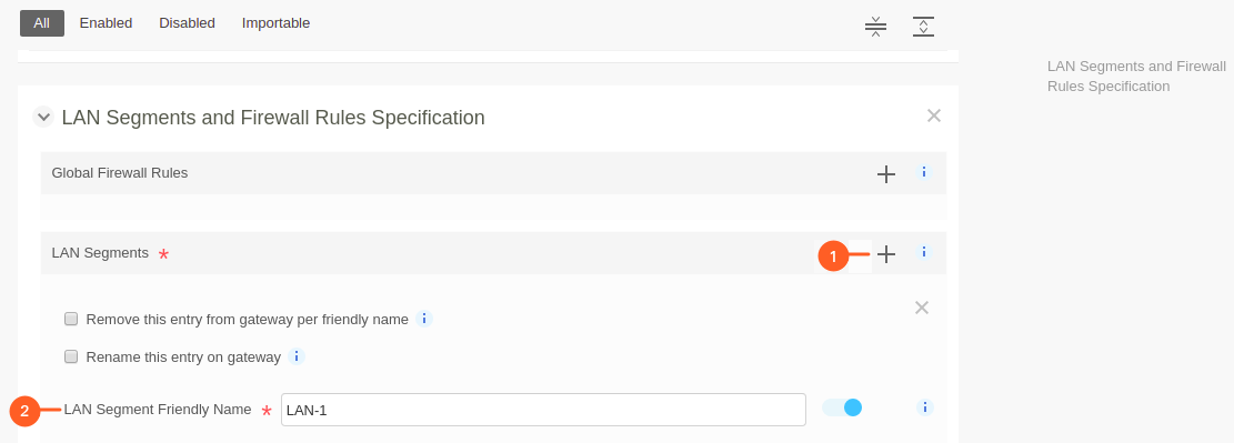

    1. To rename a rule, first create a template from scratch. See Creating a Configuration Template from Scratch
    2. To rename a LAN Networking rule, use the building block, LAN Segments and Firewall Rules Specification.

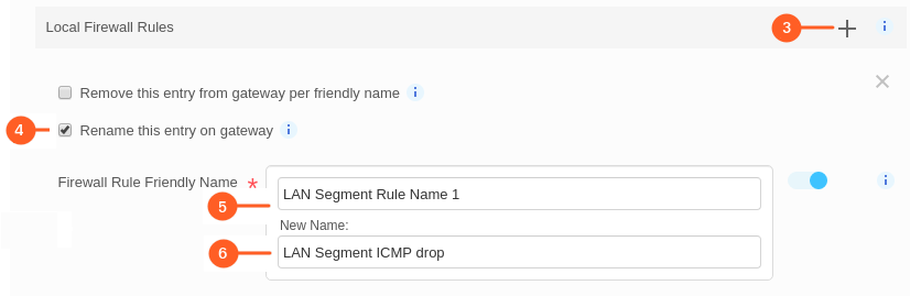

    3. Use the + button on the Global Firewall Rules to add a Networking Rule entry.
    4. For each entry, enable the Rename this entry on gateway .
    5. Enter the current Firewall Rule Friendly Name that you wish to change.
    6. Then enter the New Name .
    7. Repeat from step 3 for each rule that you wish to rename.
    8. The template is now ready to be published and deployed.
