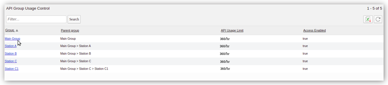

    1. Select Develop>API Group Usage Control.
    2. Select the name of the Group that you wish to change.
    3. Set the Global usage limit. The value must be greater than 0, and less than 100000.
    4. Select Save.

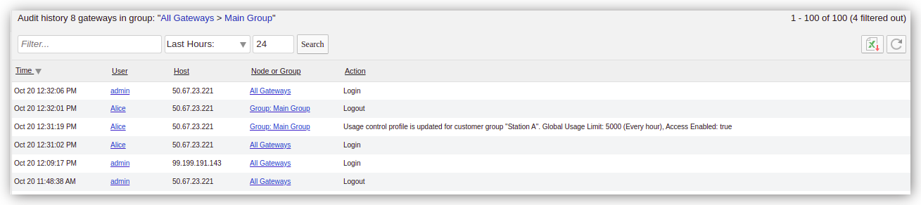

    For auditability, the change is recorded in the Admin > User Activity logs.
