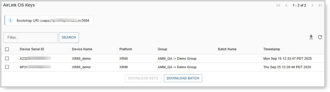

    When an AirLink OS gateway is created on the AMM, a key pair is generated. The key pair and the bootstrap URI are used to configure the AOS device, enabling it to securely identify and communicate with the correct AMM. The keys and bootstrap URI can be downloaded by going to Admin > Devices > AirLink OS Keys.
    AirLink OS Keys Screen

    1. Go to Admin > Devices > AirLink OS Keys.
    2. Select the gateway(s) for which you want keys for.
    3. Click on Download Keys.
      Note: The Download Keys is limited to the gateways displayed on the page. If there are more than 100 gateways, go to the next page and download again. Alternatively, you can use the search filter to narrow the range displayed, so that the relevant keys are on one page.
    4. You will be prompted to choose the location and filename for saving the keys. Click Save to confirm.
    2. Click on Download Batch.
    3. Enter the batch name that was used in the CSV file. Downloading a batch is not limited to 100 gateways.
