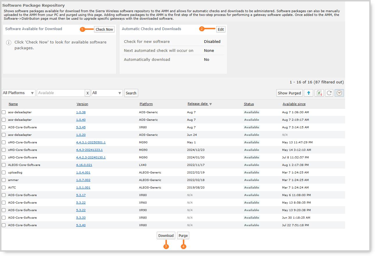

The Software Package Repository (aka “Repository”) screen, shown in the figure below, allows administrators to check for and download available software packages, upload packages from other sources, set up automatic checks, and purge packages.
Acquiring packages using this screen is the first step in the two-step process for obtaining packages and updating Semtech’s routers.

The figure above shows the following key features of the Software Package Repository screen:
Check Now: checks the Semtech servers to see if any new software packages are available for download to the AMM. The status on when the last check was performed is shown below the button. A list of selectable software
packages, if available, is shown in the grid.
Note: AMM version 2.18 and later requires aos-delsadapter version 2.0.x for use with AirLink OS routers. If it is not present, contact Technical Support.
Edit: displays the Auto Update popup in which automatic checks for software can be configured:
Auto Update Popup
Check for new software every: can be set to Day, Week, or Month. To disable this feature, select Do not check.
Start checking from: specifies the date and time from which to start performing automatic checks.
Automatically download: select this option to automatically download new software packages to the AMM. Leave this option deselected to perform the check without automatically downloading the package.
Note: In order for a customer’s AMM appliance to access the Semtech repository, the corporate firewall must be configured to allow the AMM to access repo.airlink.com over HTTPS.

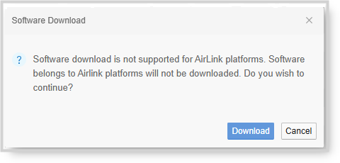

Download: downloads the selected software packages to the AMM. Only those packages with a status of New can be downloaded.
Purge: removes the selected software packages from the AMM. All selected package(s) from the list regardless of their status (except Downloading) will be removed which is useful for manually maintaining a list of relevant packages. The purged packages can be viewed using the Show Purged button described below.
