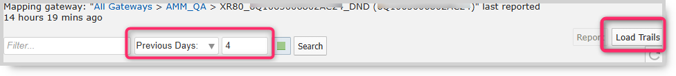

Use the drop-down menu to filter
vehicles by time since the previous report. Nominal events
(those operating within the threshold limits) are displayed by default (green square icon). De-selecting the green icon displays only those gateways in warning and error states.
Clicking in the purple arrow
displays only the gateways that have moved in the last 5 minutes.
