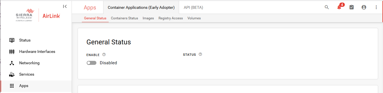

    General Status
    Under General Status, you can Enable container applications on the router and view container status.
    Enable Container Applications
    To enable the router to pull the application image and allow applications to run, you must enable the container applications feature on the router.

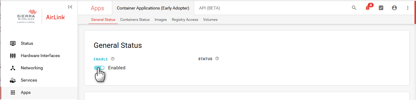

    To enable container applications:
    1. Go to Apps > Container Applications > General Status.
    2. Click ENABLE. The switch should display Enabled.
    3. Click SAVE.

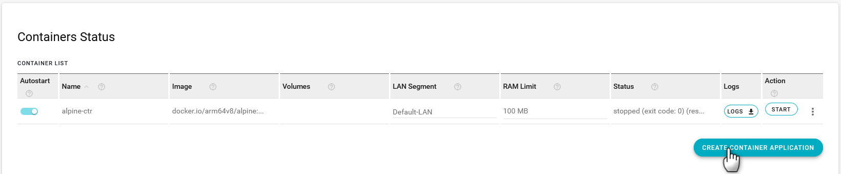

    Containers Status
    Under Containers Status you can create and run the container application.
    In the CONTAINER LIST table, you can view container parameters, retrieve container logs and manually stop and start the container.
    • Autostart–Enable automatically starting the container when the router reboots
    • Name–The name of the container application
    • Image–The Container Repository and Tag (Repository:Tag)
    • Volumes–Names of the volumes that the container is using
    • LAN Segment–The LAN Segment on which the container is configured to run
    • RAM Limit–Amount of RAM allocated to this container
    • Status
    • Logs–Click to download container logs
    • Action–Click to manually stop or start the container
    Create Container Application

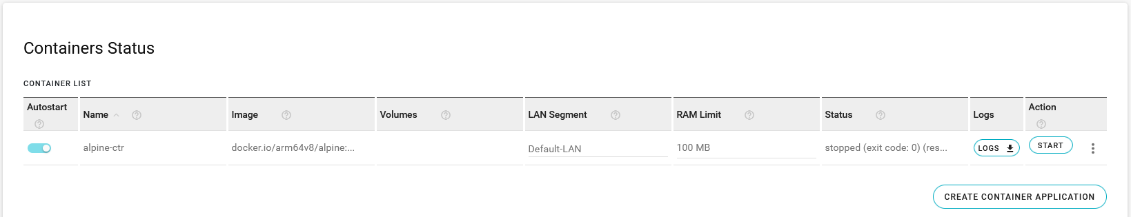

    To create the container application:
    1. Go to Container Applications > Containers Status.
    2. Click CREATE CONTAINER APPLICATION. The Create Container Application menu appears.
      • You can configure a maximum of five container applications
      • If the amount of RAM used by the configured container goes above the configured RAM usage limit defined, container processes will be killed in order of decreasing RAM utilization until the usage is below the configured limit. If the initial process launched to start the container is terminated, the container would stop with an exit code of 137. In such cases, the configured restart policy is applied.
      • At any point, the total sum of the RAM limits of all running containers cannot exceed the device-specific RAM limit.
      • When deploying a new container and doing so would cause the total sum of the RAM limits of running containers to exceed the device-specific RAM limit, the container will not start. The container will show the status as “Cannot start, RAM available on device is not sufficient”. These container start failures would not be covered by the restart policy, so the system will not attempt to restart them. You must adjust RAM usage limits prior to starting the container (see RAM LIMIT below).
    3. Configure the settings as described below and then click CREATE.

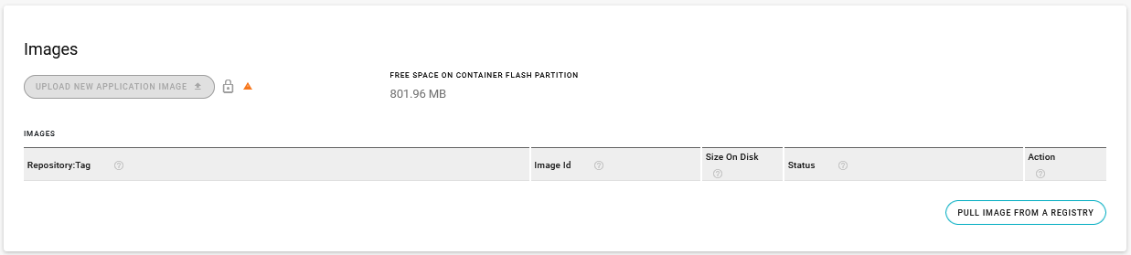

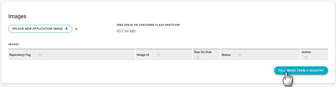

    Images
    Under Images, you can install images on the router by pulling from a registry or local upload (using the UPLOAD NEW APPLICATION IMAGE button).
    The FREE SPACE ON CONTAINER FLASH PARTITION number shown in Apps > Images indicates the space available for Apps. This space is used for storing images, volumes and container logs. It is recommended that images are pulled from an Image Registry. The UPLOAD NEW APPLICATION IMAGE interface is provided only for early trials.
    There is a limitation on the upload interface in that it works in two steps: first the image is uploaded completely to the USER partition, and then it is extracted. While the uploaded image is deleted right after this extraction, there is a brief moment when the disk requirement is double the size of the image. This creates a limitation on the maximum image size that can be uploaded from the UI.

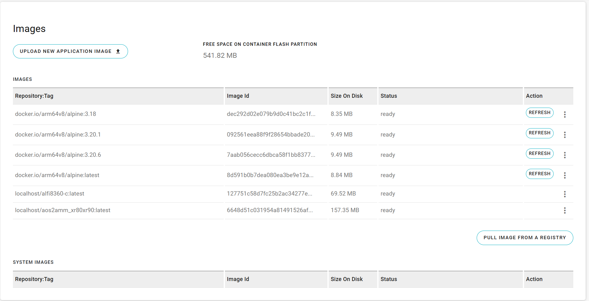

    In the IMAGES table, you can view image parameters, see status information, and manage the image.
    • Repository:Tag–The image’s repository and image reference. The repository is displayed as localhost/ if the image was uploaded locally.
    • Image ID–The unique identifier for the container image
    • Size On Disk–Size of the layers used by the image. Because layers can be shared by several images, the total size of all image and used space on the container partition may differ.
    • Status–Status of the image. For more information, you can download the logs emitted by the container application using the LOGS link in CONTAINER LIST table.
    • Action–Click the REFRESH button to fetch a new version or click RETRY to retry a failed pull. You can click to delete the image, or see additional information. An image can only be deleted if it is not currently in use.
    Pull the Application Image

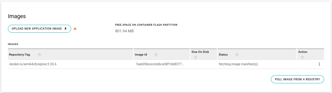

    To pull an image from the registry:
    1. Go to Container Applications > Images.
    2. Click PULL IMAGE FROM A REGISTRY. The Create Pull Image From A Registry menu appears.
    3. Enter the IMAGE REFERENCE. The reference is the path to the image file in the registry.
    4. Under SELECT REGISTRY CONFIGURATION, click x and select the Registry Configuration name.
    5. Click CREATE.
    6. Click SAVE.
    The router begins pulling the application image (you can view progress in the Status column).

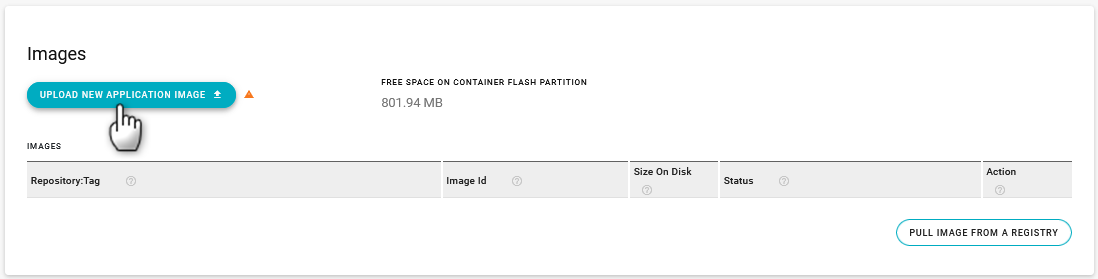

    Upload the Application Image
    In certain scenarios (debugging, for example), you may need to upload the application image locally (that is, using a laptop connected directly to the router). The image must be in a .tar file.
    To upload the image locally:
    2. Click UPLOAD NEW APPLICATION IMAGE.
    3. Upload the image .tar file.
    4. Verify that the image upload was successful, and the image is listed in the IMAGES table.

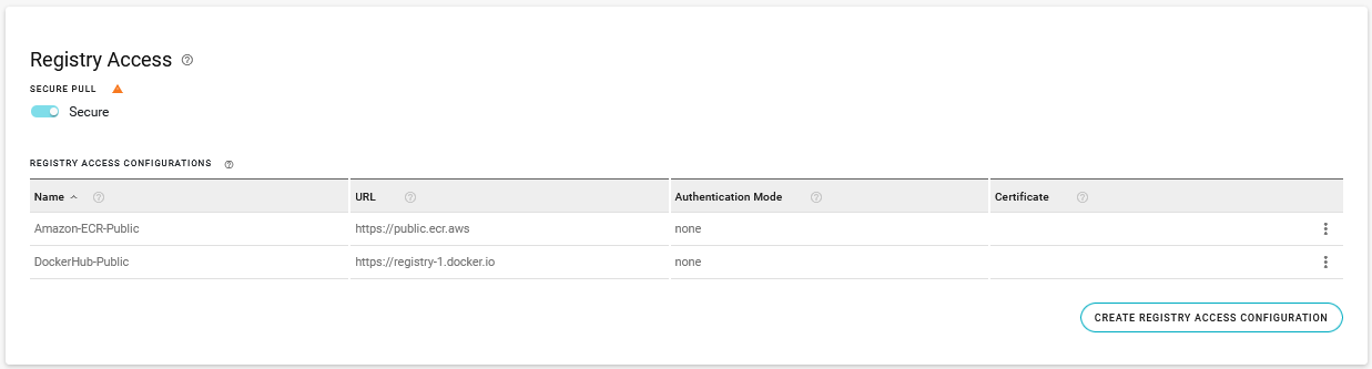

    To configure registry access:
    1. If required, disable SECURE PULL to allow pulling an image from a registry with an HTTP URL, or to skip HTTPS certificate verification. Note: Do not disable SECURE PULL in a production deployment, as it can lead to using untrusted sources.
    2. Click CREATE REGISTRY ACCESS CONFIGURATION. The Create Registry menu appears.
    3. Enter the registry NAME. This name cannot be edited after the registry is created.
    4. Enter the full URL to the registry.
    5. Select the AUTHENTICATION MODE: None (default–the server enables public access) or Basic (the server uses access control based on HTTP basic authentication).
    6. If you have selected Basic for the AUTHENTICATION MODE, enter the USERNAME and PASSWORD. If required, select the CERTIFICATE to validate HTTPS connection. You can select an existing certificate (see Security > Certificates) or create/upload a new Registry Server certificate.

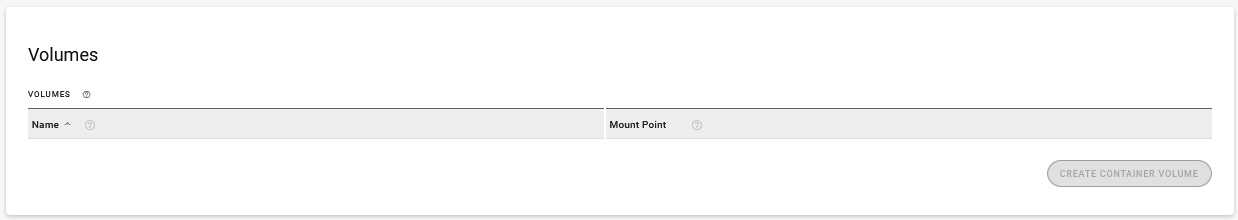

    Create the Container Volume

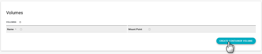

    To create the container volume:
    1. Go to Apps > Container Applications > Volumes.
    2. Click CREATE CONTAINER VOLUME. The Create Container Volume menu appears.

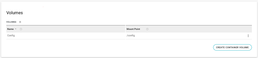

    3. Enter a NAME; config, for example.
    4. Enter the MOUNT POINT for the volume. This will be used when mounting the volume into the directory. The volume data will be stored on the USER partition and will utilize available USER partition space.
    5. For a configuration volume, upload the .tar file.
      The maximum upload file size is 64 KB per file.
    6. Click CREATE.
    7. Verify that the volume appears in the VOLUMES table.
    Verifying the Container is Working
    You can use the AirLink OS interface to verify that you have installed and started the container.
    To verify the container is working:
    1. In the CONTAINER LIST table, start the container manually.
    2. Check that the Status is Running.
    Updating a Container to a New Version
    To update a container image on the router to a newer version, you must:
    1. Pull the new image from the registry or upload it to the router directly.
    2. Edit the container configuration to reference the new image.
    The system will automatically stop the container and restart it to use the new image.
    This update can be done in one operation using a template if the router obtains the new container image using a registry pull.
