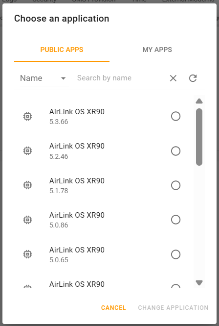

    If you are updating one router in ALMS while viewing the router configuration in ALMS (see Getting Started), you can select the software to install after you click SOFTWARE UPDATE under System > Admin > Software Update.

      When viewing the configuration in ALMS, select the desired firmware and then click CHANGE APPLICATION. You can search for software by Name or Revision number.
