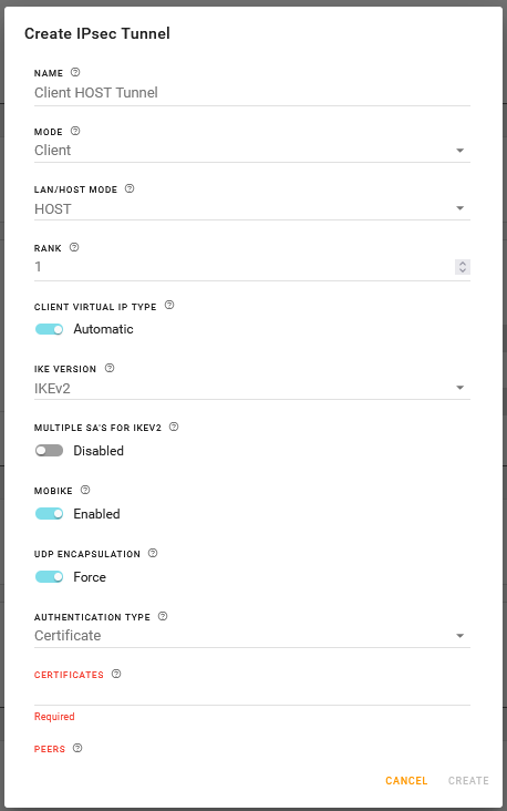

    Configuring a HOST-to-LAN tunnel in Client mode
    The settings in the procedure below are described in the IPsec Configuration Settings table above.
    To configure a HOST-to-LAN tunnel in Client mode:
    1. Enter a tunnel NAME.
    2. Set the router’s VPN MODE to Client.
    3. Set the LAN/HOST MODE to HOST.
    4. If you plan to use multiple IPsec tunnels in Client mode, set the RANK for failover priority.
    5. Select the CLIENT VIRTUAL IP TYPE.
    6. Enter a VIRTUAL IP ADDRESS, if required by the CLIENT VIRTUAL IP TYPE.
    7. Select the IKE VERSION. When IKE VERSION is set to IKEv2, you can enable or disable:
      • MULTIPLE SA’S FOR IKEV2
      • MOBIKE
    8. Select the AUTHENTICATION TYPE.
      • After selecting Certificates, you must select any existing PEM Certificates on the router, or upload the certificate components to the router.
      • After selecting PSK, you must enter a text string for the pre-shared key.
    9. Enter the PEERS as one or more IPv4 or IPv6 IP addresses.
    10. Enter LOCAL SUBNETS, REMOTE SUBNETS and any EXEMPT SUBNETS.
    11. Enter LOCAL AUTHENTICATION ID and REMOTE AUTHENTICATION ID to match the credentials for your VPN server.
    12. Select the WAN INTERFACES for VPN traffic to and from the router, in order of priority.
    13. Select whether to START the tunnel when you finish configuration and click CREATE.
    14. Configure DEAD PEER DETECTION, if desired (requires you to configure the SECONDARY PEER FOR FAILOVER).
    15. Configure IKE settings.
    16. Select whether to use PERFECT FORWARD SECURITY (PFS).
    17. If PFS is enabled, configure ESP settings.
    18. Select VPN LINK MONITORS.
    19. Click CREATE.

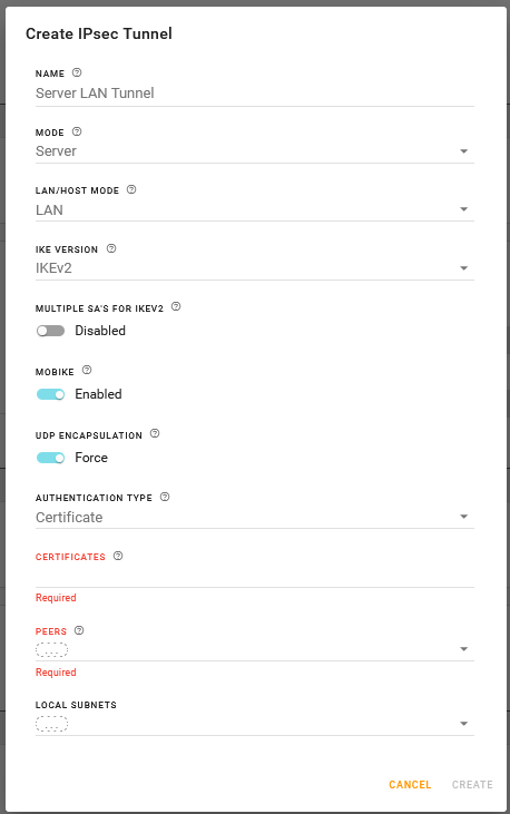

    Configuring a LAN-to-LAN tunnel in Server mode
    To configure a LAN-to-LAN tunnel in Server mode:
    2. Set the router’s VPN MODE to Server.
    3. Set the LAN/HOST MODE to LAN.
    4. Select the IKE VERSION. When IKE VERSION is set to IKEv2, you can enable or disable:
      • MOBIKE
    5. Select the AUTHENTICATION TYPE.
    6. Enter the PEERS as a single IPv4 or IPv6 IP address. Note: Server mode allows only one peer for each tunnel configuration. If you require multiple clients to access the router VPN server, then you must configure additional VPN tunnels on the router.
    7. Enter LOCAL SUBNETS, REMOTE SUBNETS and any EXEMPT SUBNETS.
    8. Enter LOCAL AUTHENTICATION ID and REMOTE AUTHENTICATION ID to match the credentials for your VPN server.
    9. Select the WAN INTERFACES for VPN traffic to and from the router, in order of priority.
    10. Select whether to START the tunnel when you finish configuration and click CREATE.
    11. Configure DEAD PEER DETECTION, if desired (requires you to configure the SECONDARY PEER FOR FAILOVER).
    12. Configure IKE settings.
    13. Select whether to use PERFECT FORWARD SECURITY (PFS).
    14. If PFS is enabled, configure ESP settings.
    15. Click CREATE.

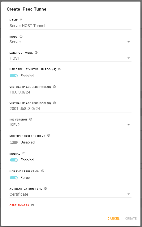

    Configuring a HOST-to-LAN tunnel in Server mode
    To configure a HOST-to-LAN tunnel in Server mode:
    4. Enable or disable USE DEFAULT VIRTUAL IP POOL(S).
    5. Enter the VIRTUAL IP ADDRESS POOL(S) (IPv4 or IPv6), if you have disabled USE DEFAULT VIRTUAL IP POOL(S).
    6. Select the IKE VERSION. When IKE VERSION is set to IKEv2, you can enable or disable:
      • MOBIKE
    7. Select the AUTHENTICATION TYPE.
    8. Enter the PEERS as a single IPv4 or IPv6 IP address. Note: Server mode allows only one peer for each tunnel configuration. If you require multiple clients to access the router VPN server, then you must configure additional VPN tunnels on the router.
    9. Enter LOCAL SUBNETS and any EXEMPT SUBNETS.
    10. Enter LOCAL AUTHENTICATION ID and REMOTE AUTHENTICATION ID to match the credentials for your VPN server.
    11. Select whether to START the tunnel when you finish configuration and click CREATE.
    12. Configure DEAD PEER DETECTION, if desired (requires you to configure the SECONDARY PEER FOR FAILOVER).
    13. Configure IKE settings.
    14. Select whether to use PERFECT FORWARD SECURITY (PFS).
    15. If PFS is enabled, configure ESP settings.
    16. Click CREATE.
