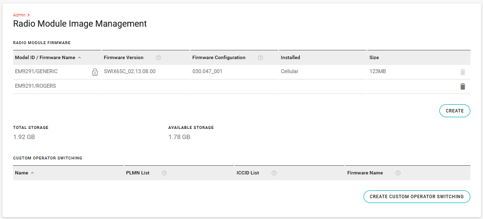

    Ensure the appropriate radio module firmware (RMFW) images are present on the router. You can check this under System > Admin > Radio Module Image Management.
    If the router came from the factory with the latest release, all the required radio module firmware (RMFW) should be present. Otherwise, add the desired RMFW image and run a software update to the same AirLink OS version to populate the RMFW image.

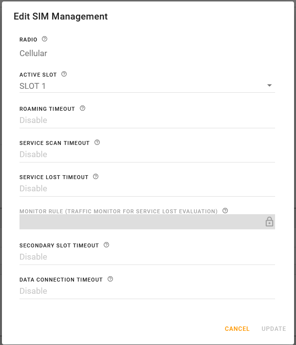

    To configure Auto SIM Switching, click in the SIM SLOT MANAGEMENT table and enter the timeout settings that will trigger a SIM switch.
    The configurable cases are Roaming Timeout, Service Scan Timeout, Service Lost Timeout, Secondary Slot Timeout and Data Connection Timeout. These settings work together, so it’s important to plan how you want automatic SIM switching to work before configuring these fields in order to reduce network downtime on the cellular interface.

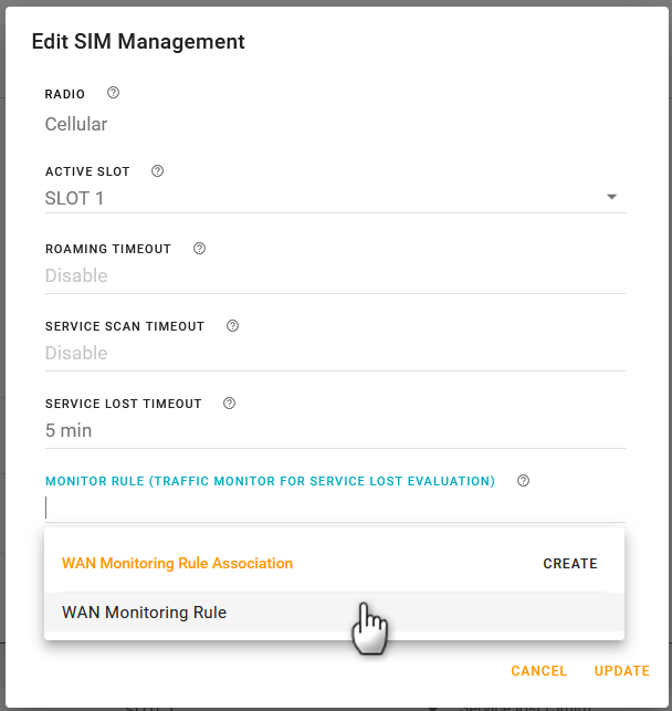

    MONITOR RULE (TRAFFIC MONITOR FOR SERVICE LOST EVALUATION)
    This setting is available when SERVICE LOST TIMEOUT is configured.
    Select an associated Network Watchdog Monitor Rule that will trigger the SERVICE LOST TIMEOUT to start.
    Click CREATE to create a new monitor rule. The Monitor Rule must monitor the Cellular interface. To configure a Monitor Rule, see Configuring the Network Watchdog.

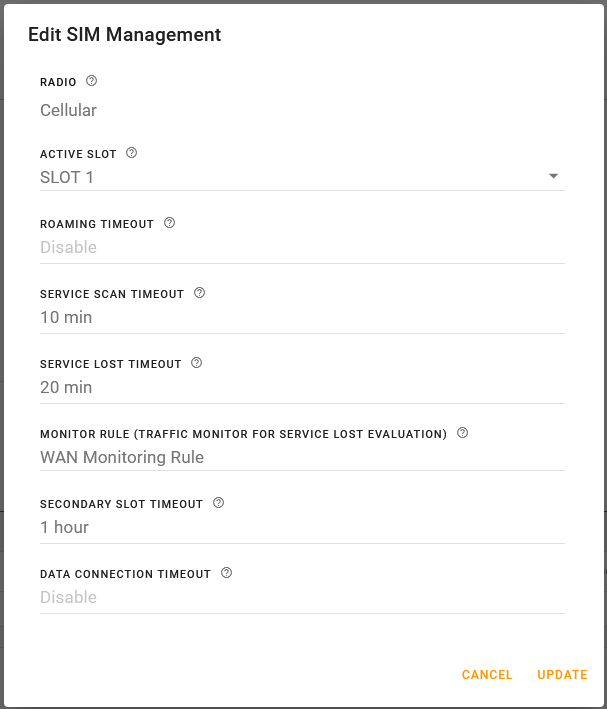

    Service Loss Example
    In this example, the desired outcome is to use the primary SIM card (for example, a less expensive network connection) whenever possible, but if necessary, to switch to the secondary SIM card to maintain the data connection.
    The Network Watchdog and Cellular Watchdog are both disabled or configured for a longer interval than the Service Loss Timeout, which enables SIM switching to persist. The watchdogs may prompt the router to reboot, which causes the router to revert to using the primary SIM card.
    For single-radio routers such as AirLink RX400, switching to the secondary SIM also loads the appropriate radio module firmware for the secondary SIM card.
    With this configuration:
    • If the router loses the data connection on the primary SIM card for 20 minutes, it switches to the secondary SIM card.
      • For single-radio routers, switching to the secondary SIM also loads the appropriate radio module firmware for the secondary SIM card.
    • If the router connects to the network using the secondary SIM card, it uses the secondary SIM card for 60 minutes and then attempts again to connect to the primary SIM card’s network.
    • If the router establishes a connection on the secondary SIM card, it will remain on this SIM card for up to 60 minutes unless service is lost for more than 20 minutes on the secondary SIM card’s network.
    • After the switch to the secondary SIM card, if the router cannot connect to the secondary network for a continuous period of 10 minutes (the Service Scan Timeout), it attempts to reconnect using the primary SIM for another 10 minutes.
      The first example below shows the router losing service on the primary SIM card. After the Service Loss Timeout expires, the router attempts to use the secondary SIM card for 10 minutes. After the Scan Timeout on the secondary SIM card expires without the router establishing a connection, the router switches back to the primary SIM card, where network service has been restored. The router reconnects.
      The second example below shows the router losing service on the primary SIM card. After the Service Loss Timeout expires, the router attempts to use the secondary SIM card for 10 minutes. After the Scan Timeout on the secondary SIM card expires without the router establishing a connection, the router switches back to the primary SIM, where network service has not been restored. The router attempts to connect using the primary SIM for another 10 minutes.

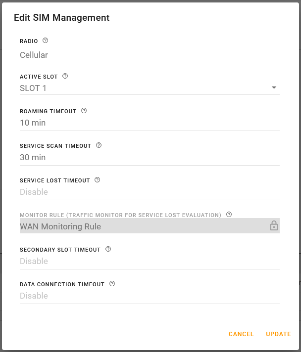

    Roaming example
    In this example, the desired outcome is to avoid roaming as much as possible, but to maintain a data connection if the roaming network is the only one available.
    • If the router is roaming on the primary SIM for 10 minutes, it switches to the secondary SIM.
    • If the secondary SIM card’s network is not immediately available, the router continues to attempt to connect for 30 minutes. If, after 30 minutes, the router is still unable to establish a data connection with the secondary SIM, the router switches back to the primary SIM.
