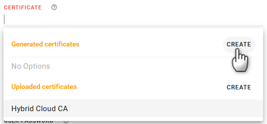

    CERTIFICATE
    Select the server root CA (Certificate Authority) certificate, or client certificate and client key.
    If the certificate is not present:
    • For Generated certificates, clicking CREATE will open the Create Certificate Signing Request screen, where you can enter a certificate signing request to be sent to your certificate management system. See Managing Security Certificates for more information.
    • For Uploaded certificates, clicking CREATE will open the Create Certificates screen, where you can upload a new certificate.
