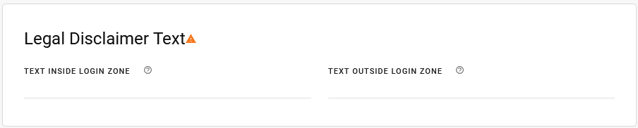

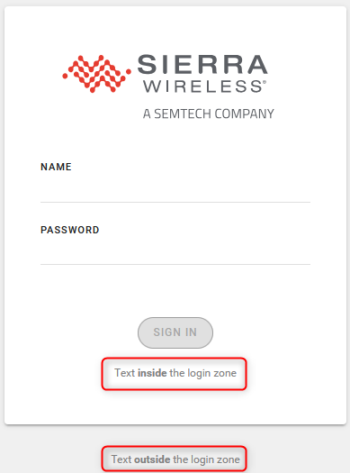

    This section allows you to define up to two messages on the login screen. The messages support markdown.
    Note: Any text shown on the login screen will be visible without authentication.
    SETTING DESCRIPTION
    TEXT INSIDE LOGIN ZONE Enter text to appear inside the login zone under the SIGN IN button
    TEXT OUTSIDE LOGIN ZONE Enter text to appear outside the login zone
    Example:
