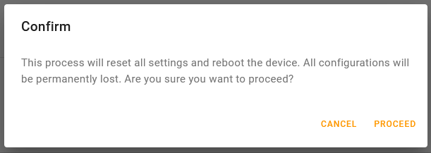

    Resetting the Router
    To reset the router:
    1. Click RESET SETTINGS. A confirmation message appears.
    2. Click CANCEL to cancel the reset, or click PROCEED to reset the router.
