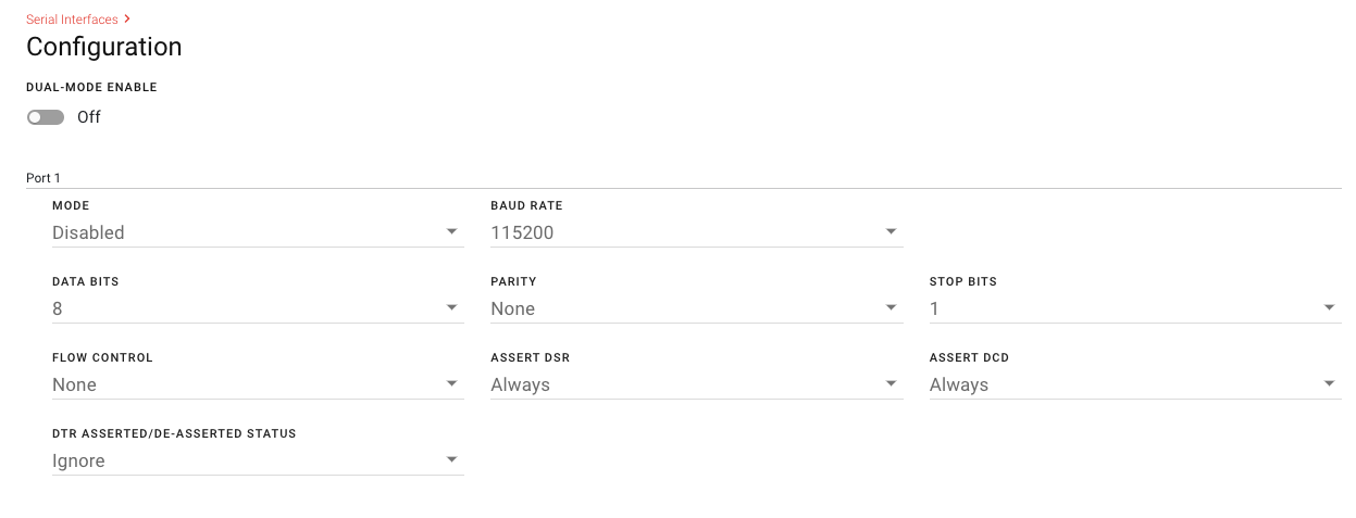

The same serial port can be configured as a dual 4-wire+ 2-wire serial port, and connect to devices with a Y cable (Sierra Wireless part number 6001238). The Dual Port Mode setting is available in AirLink OS under Hardware Interfaces > Serial > Configuration > Dual-Mode Enable.
See the RX55 Hardware User Guide for the pinout information for single and dual port modes.
SETTING | DESCRIPTION | |
DUAL-MODE ENABLE | Configures the serial port as a dual 4-wire + 2-wire serial port. When dual port mode is enabled, you can configure the Port and PAD settings for each port independently. | Off(default), On |
SETTING | DESCRIPTION | RANGE/OPTIONS |
MODE | When Packet Assembler/Disassembler(PAD) mode is enabled, additional settings appear for that port. See Configuring PAD Settings | Disabled(default), PAD |
BAUD RATE | Configures port speed | 115200 (default), 4800, 9600, 19200, 38400, 57600, 115200, 230400 |
DATA BITS | Number of bits used to represent each character of data | 8 (default), 7 |
PARITY | Additional bit used for error checking | None (default), Odd, Even |
STOP BITS | One or more bits that indicate the end of a data frame | 1 (default), 2 |
FLOW CONTROL |
Flow control enables the receiving device to control the data flow. This is useful if the receiving device has a heavier traffic load or less processing power than the sending computer.
ASSERT DSR | Assert DSR always, or when the device is in a data mode (UDP, TCP, etc.), or when the device is in network coverage. Note: This setting is not available in dual port mode. | Always (default), In Data Mode, WAN Ready (In Coverage) |
ASSERT DCD | Assert DCD always, or when the device is in a data mode (UDP, TCP, etc.), or when the device is in network coverage. Note: This setting is not available in dual port mode. | Always (default), In Data Mode, WAN Ready (In Coverage) |
DTR ASSERTED/DE-ASSERTED STATUS | Assert DTR when the device is in a data mode (UDP, TCP, etc.), or when the device is in network coverage, otherwise ignore. | Ignore (default), In Data Mode |

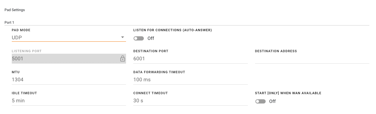

When MODE is set to PAD, the following settings will appear and can be configured:
PAD MODE using UDP
PAD MODE | Sets the protocol used to send messages | TCP (default), UDP |
LISTEN FOR CONNECTIONS (AUTO-ANSWER) | When set to the DISABLED state, the router functions as a client. When in the ENABLED state, the router can function as a client or accept incoming connections and act as a server | Off (default), On (makes LISTENING PORT available) |
LISTENING PORT | The port on the AirLink router used for incoming TCP communication | 1–65535, 5001 (default) |
DESTINATION PORT | The destination port that TCP/UDP communication is sent to | 1 to 65535, 6001 (default) |
DESTINATION ADDRESS | IP address TCP/UDP communication is sent to | n/a |
MTU | The serial maximum transmit unit (PAD payload) | 256 to 4096, 1304 (default) |
DATA FORWARDING TIMEOUT |
The Data Forwarding Timeout feature causes AirLink OS to send a new PAD packet if the timeout has expired since it last received data on the serial port. |
0–255, 100 ms (default) |
IDLE TIMEOUT | Specifies a time interval during which, in the absence of any inbound or outbound traffic through a TCP connection, the connection will be terminated | 0 to 255, 5 min (default) |
CONNECT TIMEOUT | Specifies the number of seconds to wait for a TCP connection to be established when dialing out | 0 to 255, 30 s (default) |
START [ONLY] WHEN WAN AVAILABLE | When On, only start connection attempt when a WAN link is available. The connection will be closed when WAN is unavailable | Off (default), On |
