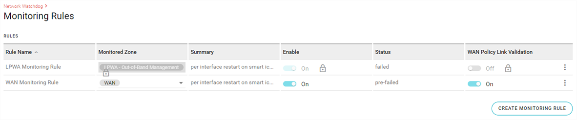

    The RULES table shows you the configuration and status of each Network Watchdog Monitoring Rule. From the RULES table, you can also configure some of the rule settings:
    • Select the Monitored Zone(s)
    • Enable or disable the rule
    • Turn WAN Policy Link Validation on or off.
    For more information, see the table below.
    COLUMN DESCRIPTION
    RULE NAME Name used to identify the rule.
    MONITORED ZONE Zone that is being monitored. Click the field to select a different or additional User Zone, System Zone or Interface
    SUMMARY Summary of the monitoring rule’s ACTION and METHOD. For example, the summary “per interface restart on smart icmp ping failure” indicates that the interface will restart if the “ICMP ping on idle traffic” monitoring method detects a network failure (“smart” refers to the “idle traffic” element of the monitoring method). See Configuring a Monitoring Rule.
    ENABLE Enable or disable the Monitoring Rule
    STATUS
    Current status of the rule
    • ok - Everything is working correctly
    • failed - Monitoring has failed and MAX FAILURES limit was reached. The configured ACTION will be performed (restart/reboot)
    • pre-failed - Monitoring is starting to fail, but hasn’t reached the MAX FAILURES limit yet
    • disabled - Monitoring rule is disabled and not running
    WAN POLICY LINK VALIDATION Enable or disable WAN POLICY LINK VALIDATION. See Configuring a Monitoring Rule.

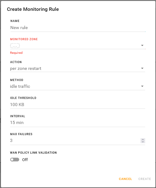

    1. Go to Networking > Network Watchdog > Monitoring Rules.
    2. Click CREATE MONITORING RULE to create a new rule, or click Edit ( ) in the RULES table to update an existing rule.
    3. Begin configuring the Monitoring Rule by entering a rule NAME.

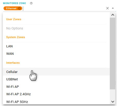

    4. Click the MONITORED ZONE field to choose which Zones (System Zones or your own defined zones) or interfaces you want to monitor. Zones are a group of interfaces. Add as many Monitored Zones as you want.
      WARNING : When selecting the MONITORED ZONE, ensure that you do not select an interface or zone that already has a network monitoring rule applied. Multiple networking monitor rules are not supported on the same interface.

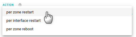

    5. Select the ACTION the router will take when the value of the MAX FAILURES field is reached for the configured INTERVAL:
      • per zone restart restarts all interfaces in the monitored zone when all interfaces in the monitored zone are down.
      • per interface restart restarts an interface in the monitored zone when that interface is down.
      • per zone reboot reboots the router when all interfaces in the monitored zone are not working.

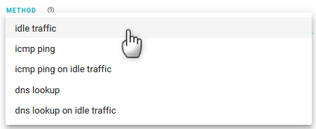

    6. Select the monitoring METHOD:
      • idle traffic allows you to monitor without sending a ping. AirLink OS monitors traffic (TX/RX bytes per second) to determine whether the selected interface(s) are operating. This method is suitable for satellite links, where you want to minimize monitoring-related traffic (such as pings or DNS lookups used by other methods).
        • After selecting the idle traffic method, configure the IDLE THRESHOLD. This is the threshold at which traffic is considered to be “idle”. You can raise or lower the threshold depending on the interface being monitored. For example, if a Wi-Fi interface has “idle” noise levels of 500B/s (TX) and 95KB/s (RX), you can set the threshold to 100KB/s.
      • ICMP ping: sends ping traffic at a configured interval whether the interface is idle or carrying traffic.
      • ICMP ping on idle traffic: sends a ping when the router detects idle traffic (no increase in RX/TX values is detected).
        • After selecting the ICMP ping on idle traffic method, select the IDLE THRESHOLD. See above for description.
      • DNS lookup: attempts to resolve host names at a configured interval whether the interface is Idle or carrying traffic.
      • DNS lookup on idle traffic tries to resolve the hostname when traffic is considered idle. Some firewalls do not allow ICMP pings through, so DNS lookup is the best option in that case.
        • After selecting the DNS lookup on idle traffic method, select the IDLE THRESHOLD. See above for description.
    7. Select the INTERVAL. Depending on the monitoring method you’ve selected, the interval determines:
      • How often a ping is sent. Frequent pings are used especially for Wi-Fi links.
      • How often the router checks TX/RX bytes to determine if traffic is idle.
    8. Select the MAX FAILURES (from 1 to 10) to set the number of successive failures (failed pings or idle traffic detected, depending on your monitoring method) before the router takes the specified action.

    12. Click CREATE.
