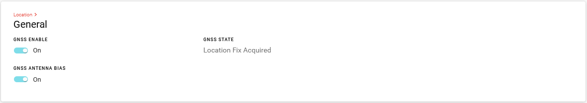

    1. Under Services > Location > General, ensure that GNSS is enabled.

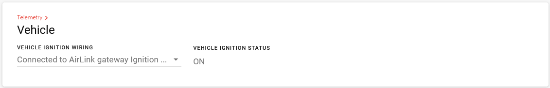

    3. Under Services > Telemetry > Vehicle set VEHICLE IGNITION WIRING to Connected to AirLink gateway Ignition Sense input line.

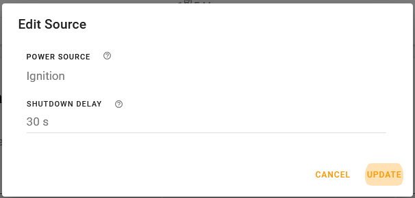

    4. Under MCU > Power Management, configure the ignition SHUTDOWN DELAY to be at least 30 seconds.
      • In the POWER SOURCES table, click Edit ( ) on the row for Source > Ignition.
      • Set the SHUTDOWN DELAY to at least 30 seconds.
      • Click UPDATE.
