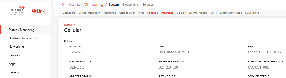

AirLink OS lists its main sections in a menu along the left. Clicking a section heading displays a list of all sub-sections on that page.
The menu across the top shows you the sub-sections of the page. Clicking a heading in the top menu takes you to that sub-section.
