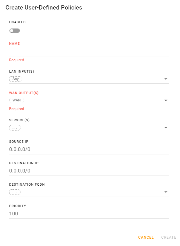

    Multi-WAN rules define the WAN devices that can carry various types of data traffic. You can select the traffic type based upon the origin (LAN bridges/zones), destination ports(services), source/destination addresses, or FQDN.
    In the case that you have rules with overlapping elements, you can assign a priority to your rules, from 100 to 999. For example, if you have a rule with Source IP of 192.168.1.100 at Priority 100 and a rule with Source IP of 192.168.1.1/ 24 at Priority 101, traffic from 192.168.1.100 is routed to 192.168.1.100, and the other rule is ignored.
    AirLink OS has two default rules already defined: the default routes for IPv4 and IPv6 traffic (priority 998 and 999 respectively). Traffic that is not carried by any other multi-wan policy will use one of these two rules. These default rules use the default system WAN zone. You can edit the WAN Output(s) fields to use other zones.
    • Enabled: Sets whether the policy rule is active or not
    • Name: A description for the policy.
    • LAN Input(s): Specifies the source of the traffic. If left blank, the policy applies to all traffic from any LAN device or traffic from the router itself. For example, router traffic includes ALMS LWM2 traffic and DNS queries. You can select LAN Segments (configured under Networking > Zones > LAN Segments) or LAN Zones.
    • WAN Output(s): Specifies the ordered list of interfaces the traffic can be carried over. This can be configured using a Zone or specific WAN interfaces. Default policies use the WAN zone to define the default device order. The default device preference is Ethernet, Wi-Fi, Cellular, and finally USB interfaces (USB interfaces may not be implemented yet).
      • To change the order, you can either select interfaces in priority order, or you can define a new Zone. Zones are configured under Networking > Zones > System Zones.
      • For example, if traffic from Default-LAN should use Cellular 1 first, then Cellular 2 (if Cellular 1 is unavailable), you can select Cellular 1 and then Cellular 2. Alternatively, you can create a new zone called MyZone with Cellular 1 and Cellular 2. Then MyZone can be applied to any policy rule.
    • Service(s): Specifies a protocol/destination port number to identify the traffic. If left empty, all traffic types (TCP, UDP, ICMP) will be matched against this policy. You can configure Services at Networking > Zone Settings > Services.
    • Source IP and Destination IP: Specifies a source/destination to match against this traffic (either IPv4 or IPv6). You can enter an IPv4 or IPv6 IP address, and AirLink OS will validate it. Note that if both IPv4 and IPv6 traffic is to be selected, two policies must be created.
    • Destination FQDN: You can specify a Destination FQDN instead of a fixed Destination IP address. To use a Destination FQDN, clear the Destination IP field. Click the Destination FQDN field to select a pre-configured FQDN, or click CREATE to create a new FQDN entry. You can also create a new FQDN entry under Zones settings > Fully Qualified Domain Names.
    • Priority: Defines the order in which policies are evaluated, in ascending order. For example, if you create a rule with priority 100, it will apply first and override the default 998 and 999 policies. Each policy must have a unique priority; AirLink OS does not allow policies with identical priorities.
    Click CREATE USER-DEFINED POLICIES to configure and add a user-defined rule.

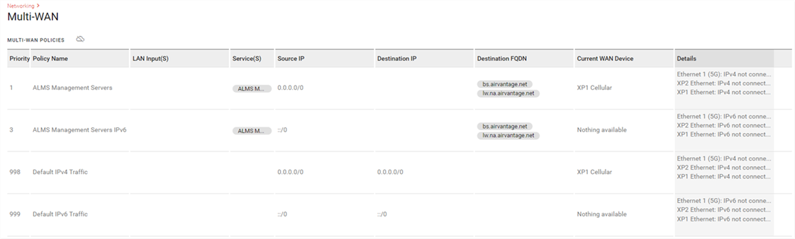

    Confirming Your Configuration
    Go to Status/Monitoring > Networking > Multi-WAN to see your configured policy routes and priorities.

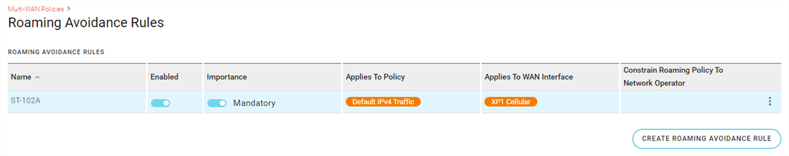

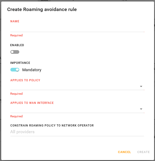

    Roaming Avoidance Rules
    • Name: Enter a unique name.
    • Enabled: Select to enable/activate this rule.
    • Importance: Enable to make the rule Mandatory. When the rule is set to mandatory, the WAN interface must never be used if Roaming. Disable to make the rule Optional. When the rule is optional, the WAN interface should not be used if Roaming and another WAN interface is available. If no other interface is available, use this optional interface even if it is roaming.
    • Applies to Policy: Apply this roaming rule against the specified WAN policy.
    • Applies to WAN Interface: Apply this rule against the specified interface used in the WAN policy configured in Applies to Policy. Note: this must be a cellular interface.
    • Constrain Roaming Policy to Network Operator: The roaming rule applies only if currently connected to the specified provider.
    Click CREATE ROAMING AVOIDANCE RULE to configure and add a Roaming Avoidance rule.

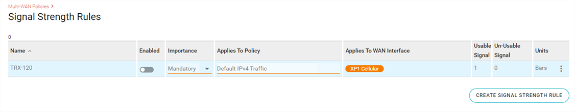

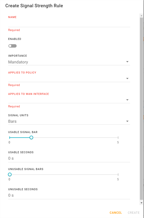

    Signal Strength Rules
    • Importance: Enable to make the rule Mandatory. When the rule is set to mandatory, the WAN interface must never be used if outside of the configured signal strength. Disable to make the rule Optional. When the rule is optional, the WAN interface should not be used when outside of the configured signal rule and another WAN interface is available. If no other interface is available, use this optional interface even when it does not meet the signal requirements.
    • Applies to Policy: Apply this signal strength rule against the specified WAN policy.
    • Applies to WAN interface: Apply this rule against the specified interface used in the WAN policy configured in Applies to Policy, and can either be a Cellular or Wi-Fi interface.
    • Usable/Un-usable signal strengths can be configured in either abstracted signal bar strength or RSSI. In addition, hysteresis can be defined for the signal strengths as shown in the following graph:
      The graph shows that the signal needs to be greater than or equal to the Usable signal strength for at least the Usable time period (in seconds) before the interface is considered usable. Once the signal drops below the Unusable signal for more than the Not Usable time period (in seconds), the interface is considered unusable.
    Click CREATE SIGNAL STRENGTH RULE to configure and add a signal strength rule.

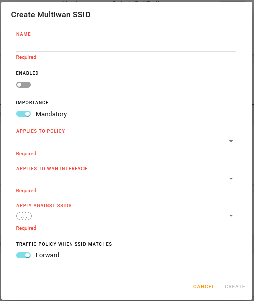

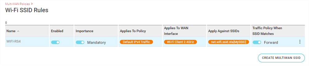

    Wi-Fi SSID Rules
    • Enabled: Select to Enable/activate this rule
    • Importance: Enable to make the rule Mandatory. When the rule is mandatory, the Wi-Fi rule must always apply even if it results in traffic not being able to be transported via another available interface. Disable to make the rule Optional. When the rule is optional, the WAN interface should not be used if another interface is able to carry the traffic, but if no other interface is available, use it regardless of the Wi-Fi SSID rule.
    • Applies to Policy: Apply this SSID rule against the specified WAN policy.
    • Applies to WAN Interface: Apply this rule against the specified interface used in the WAN policy configured in Applies to Policy. Note that it must be a Wi-Fi WAN interface.
    • Apply against SSIDs: The rule becomes active if the Wi-Fi client is currently connected to one of the specified SSIDs. See Wi-Fi Interfaces > Client SSID Database for the list of SSIDs available to be added this rule.
    • Traffic Policy when SSID Matches:
      • Forward: the interface can be considered usable if connected to the specified SSIDs (forms an acceptance list). In the example above, if connected to MySSID, the device will be considered usable.
      • Block: the interface will not be usable if connected to the specified SSIDs (forms a block list).
    Click CREATE MULTIWAN SSID to configure and add a Wi-Fi SSID rule.

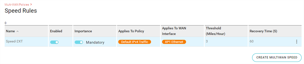

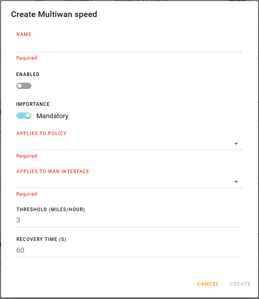

    Vehicle Speed Rules
    The speed of a vehicle is obtained through GNSS. To enable this feature, GNSS Enable under Services > Location > General must be On. It is essential to have a connected GNSS antenna for optimal signal strength. If GNSS is disabled, then Vehicle Speed Rules will not be present in Multi-WAN policies.
    • Importance: Enable to make the rule Mandatory. When the rule is mandatory, the WAN interface must never be used if vehicle speed exceeds a threshold (miles per hour). Disable to make the rule Optional. When the rule is optional, the WAN interface should not be used if another interface is able to carry the traffic, but if no other interface is available, use it even if the threshold has been exceeded.
    • Applies to Policy: Apply this speed rule against the specified WAN policy.
    • Threshold (Miles/hour): When the vehicle speed is above this threshold, the Speed rule will inhibit traffic on the selected WAN interface.
    • Recovery Time (seconds): Once vehicle speed has exceeded the threshold and data traffic is dropped, recovery time specifies how long the vehicle must be below the speed threshold before traffic is permitted on the selected WAN interface.
    Click CREATE MULTIWAN SPEED to configure and add a Speed rule.
