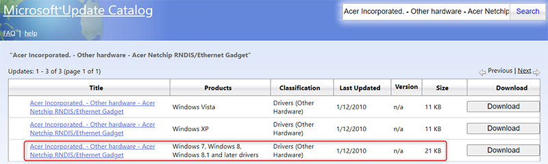

    Windows 10 / 11 Using Downloaded Driver
    1. Open the Microsoft Update Catalog and download the driver package for Windows 8.1 and later.
    2. The package will be in the form of a CAB file. Double-click the package to view the compressed contents, and extract both files to a location on your drive.
      • You will need to navigate to that location later to specify the driver.
      • If the security catalog file is not found with the driver INF file during installation, the driver will be seen as unsigned and Windows will reject it.
