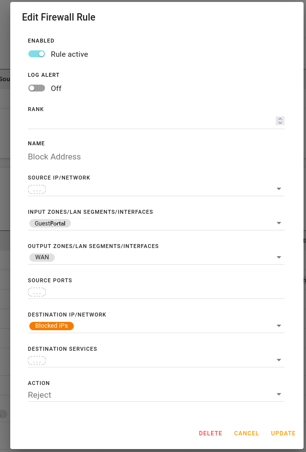

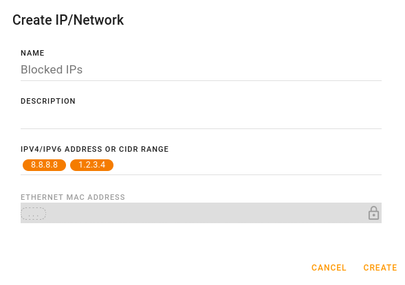

    • If you want to block certain IP addresses for clients while they are using the captive portal, then you will need to:
      1. Create an address zone for the blocked IP addresses. For more information about Device IP/Network zones, see Device IP/Network Configuration.
      2. Create a firewall rule that blocks traffic to these addresses. For more information about firewalls, see Firewall Configuration on the Captive Portal LAN Segment.

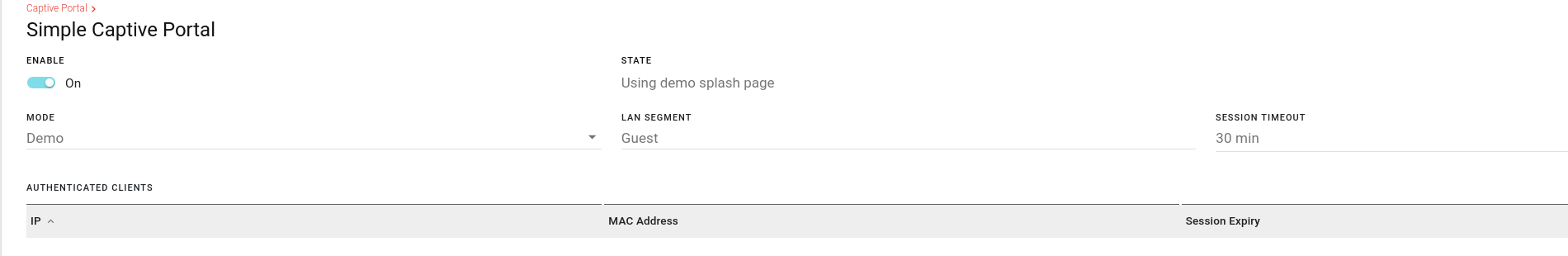

    To configure Simple Captive Portal, go to Networking > Simple Captive Portal and enable it. The Simple Captive Portal settings are listed and described below.
    SETTING DESCRIPTION
    ENABLE
    Enable or disable the simple captive portal.
    • Off (default)
    • On
    STATE
    Status of the simple captive portal. The status depends on the mode you’ve selected (see MODE below for more information).
    • Disabled
    • Using demo splash page when enabled and operating in Demo mode
    • Using uploaded splash page when enabled and operating in Local mode. This is to let you know that you have successfully deployed the uploaded splash page.
    • Using installed splash page when enabled and using the previously uploaded splash page in Local mode after one or more router reboots. This is to let you know that the router is continuing to use the uploaded splash page. After the router reboots the locally uploaded .tar.gz file is purged from the router’s memory.
    • Using downloaded splash page when enabled and operating in Remote mode
    • Invalid package if the uploaded or downloaded .tar.gz is incorrect and cannot be used, or the upload/download was incomplete.
    MODE
    You can select the following modes for displaying the Simple Captive Portal splash page:
    • Demo: Uses the router’s default built-in splash page. The Demo mode is meant for temporary initial configuration and test purposes. For field deployments, uploading a customized splash page using Local or Remote modes is recommended.
    • Local: Allows you to upload your own captive portal splash page using the local UI. Uploading your own captive portal splash page is not available when configuring Simple Captive Portal using the AirLink OS UI in ALMS.
    • Remote: Allows you to host a splash page on a remote server for the router to download. This is ideal for a fleet deployment, so that multiple devices can download the same splash page.
    When you switch modes, any connected clients will be disconnected from the captive portal.

    Monitoring Simple Captive Portal Activity
    In the AUTHENTICATED CLIENTS table, you can view information about devices (LAN IP Address, device MAC address and Session Expiry time) that have connected to the WAN using the Simple Captive Portal.
