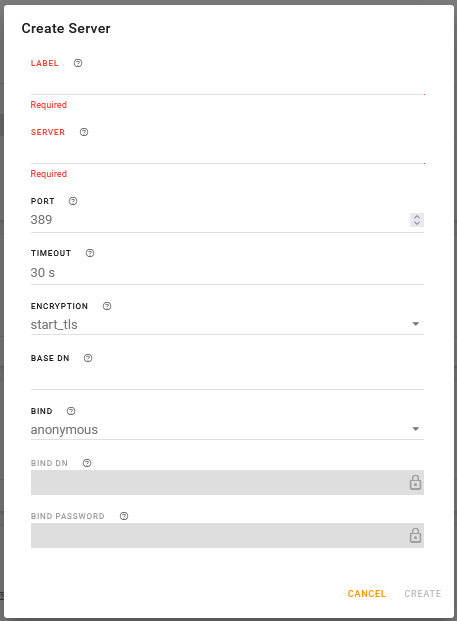

This section enables the configuration of LDAP version 3 servers for use by the AirLink router to perform user authentication.
The following settings can be used to configure LDAP authentication.
| SETTING | DESCRIPTION | RANGE | DEFAULT |
| LABEL | Enter a name for your LDAP configuration. This will appear in the LDAP CLIENT field. | N/A | N/A |
| SERVER | Required LDAP server IP address or resolvable domain name | N/A | N/A |
| PORT | Port number | 1 to 65535 | 389 |
| TIMEOUT |
The time limit for the server to respond. |
1 to 60 seconds | 30 seconds |
| ENCRYPTION | Encryption type. |
start_tls |
| BASE DN | The Base DN is the path in the LDAP tree to the list of users (e.g. dc=sierrawireless,dc=com). This is where the LDAP protocol searches for a matching user to authenticate. | N/A | N/A |
| BIND | Choose how the LDAP search is done |
anonymous |
| BIND DN | This field is available if you selected Explicit in the BIND field. The full path of the user authorized to perform requests in the LDAP | N/A | N/A |
| BIND PASSWORD | This field is available if you selected Explicit in the BIND field. Password associated with the Bind DN | N/A | N/A |

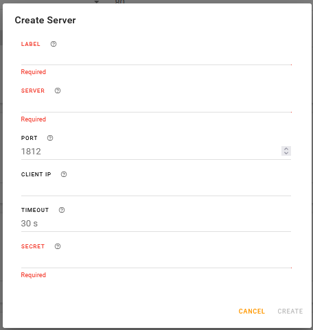

This section enables the configuration of the Remote Authentication Dial In User Service (RADIUS) which uses UDP to perform user authentication with a shared key.
The following settings can be used to configure RADIUS authentication.
| LABEL | Enter a name for your RADIUS configuration. This will appear in the RADIUS CLIENT field. | N/A | N/A |
| SERVER | Required RADIUS server IP address or resolvable domain name | N/A | N/A |
| PORT | Port number | 1 to 65535 | 1812 |
| TIMEOUT |
The time limit for the server to respond Note: If the server does not respond during the timeout, the authentication fails and the next enabled authentication mechanism checks the credentials. |
| SECRET | Shared secret for configured server | N/A | N/A |

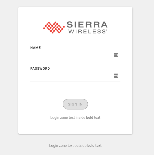

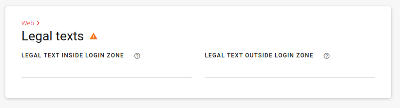

This section allows you to define up to two messages on the login screen. The messages support markdown.
Note: Any text shown on the login screen will be visible without authentication.
| LEGAL TEXT INSIDE LOGIN ZONE | This will display the text inside the login zone under the SIGN IN button |
| LEGAL TEXT OUTSIDE LOGIN ZONE | This will display the text outside the login zone |
Example:
