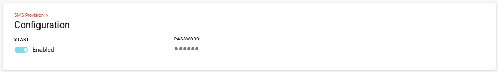

    2. Under System > SMS Provision > Configuration, enable START (enabled by default).
    3. Set the SMS Provision password. (By default, this is the AirLink OS admin password. Sierra Wireless recommends configuring a unique SMS password.)
