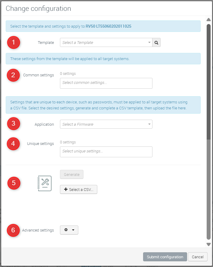

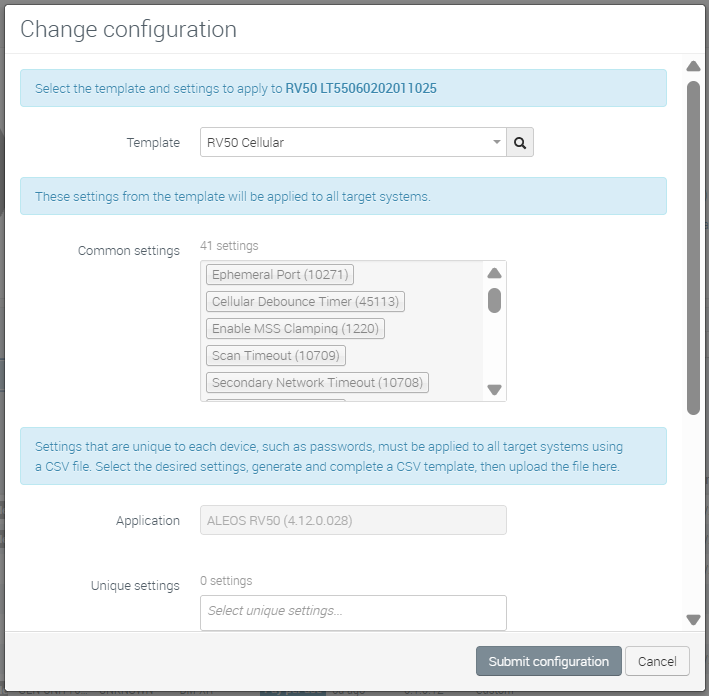

    ALEOS-based systems: Generate, download, and upload a CSV file

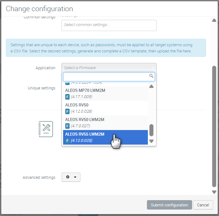

    1. Select an Identifier for the systems: Name, Serial Number, or IMEI, for example. The identifier will populate the first column of your .csv file.

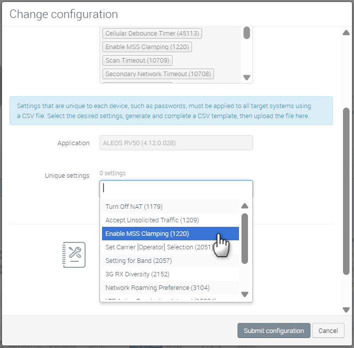

    2. Select the Setting you want to change for each system:
      • Select the application; that is, the device and software: ALEOS MP70 (4.12.0), for example. You can only change settings on identical systems.
      • Select the setting you want to change.
    3. Click Generate.

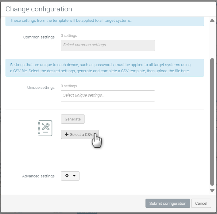

    4. After the .csv file generates, click Download your template…
    5. Edit your downloaded .csv file to add the new value(s) for the setting you want to apply to each system.
    6. Save your .csv file.
    7. Click Select a CSV…, browse to your .csv file and then click Open.

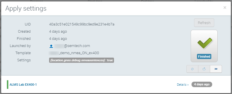

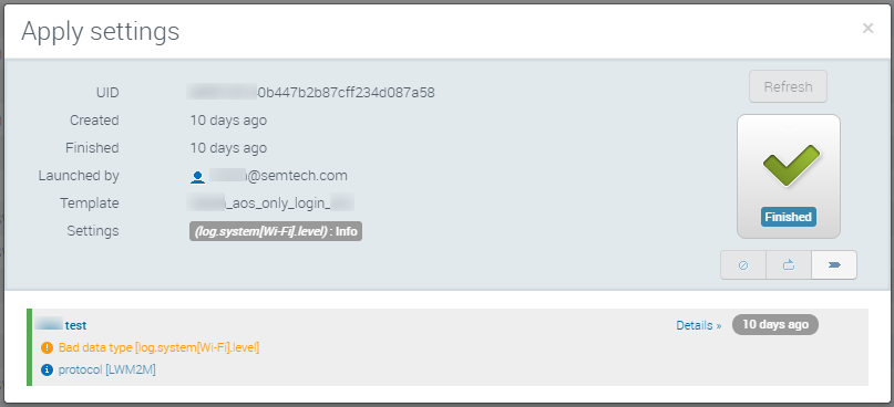

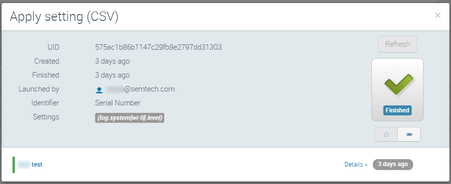

    An operation is created, you can follow the progress from the Operations list. For each system, at the next heartbeat, the setting will be configured, overwriting the previous value.

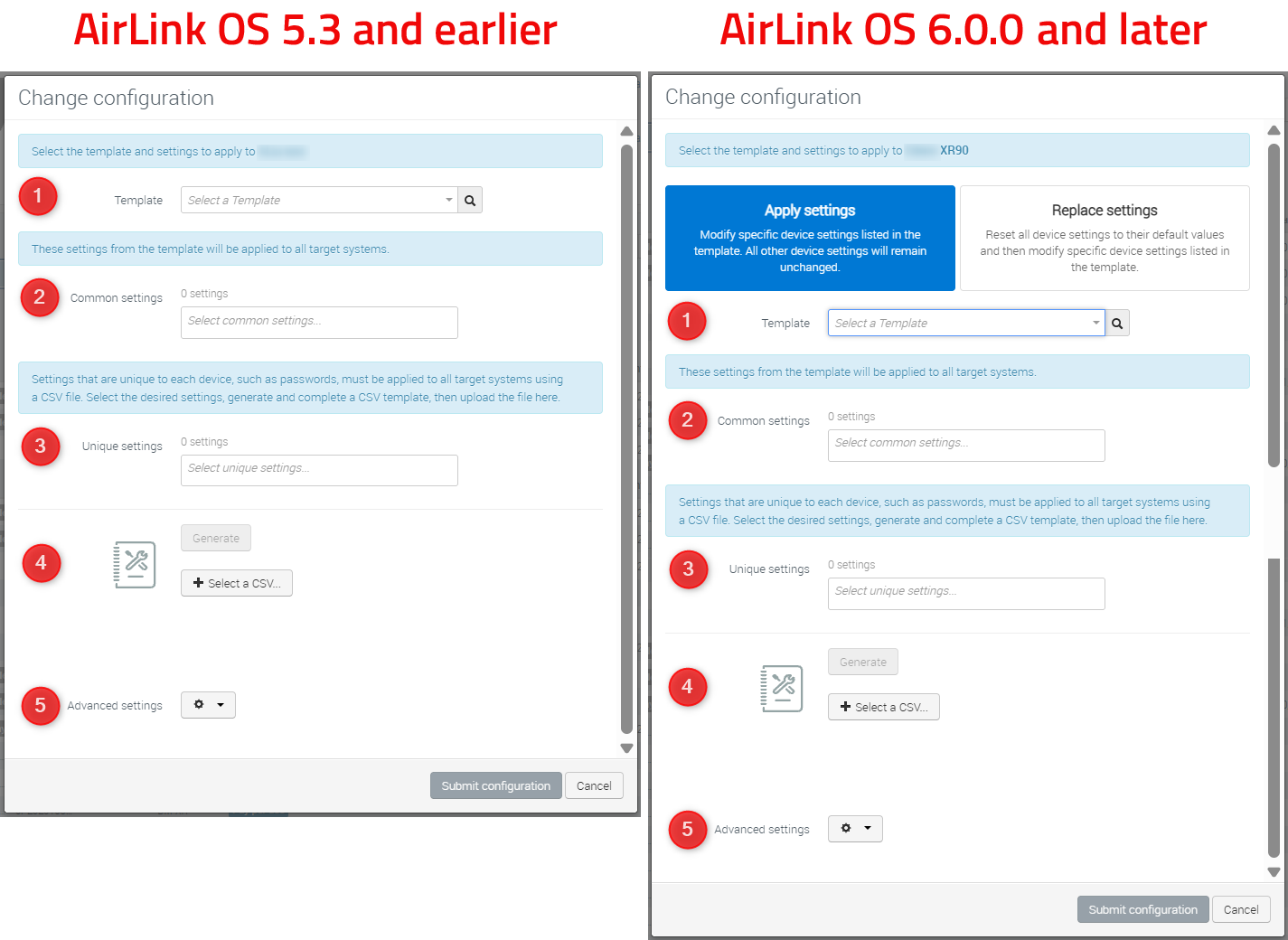

    For AirLink OS devices (XR90 and XR80 routers, for example), you must select an existing dataset from which to select the setting(s) you want to change for multiple devices. For more information about datasets, see How to create a dataset? .
    1. Select an Identifier for the systems: Name, Serial Number, or IMEI, for example. The identifier will populate the first column of your template.

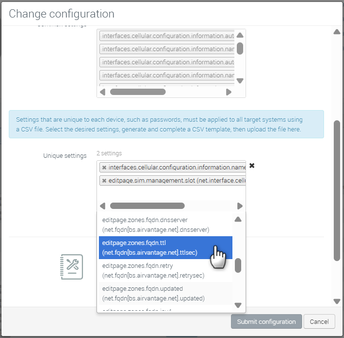

      • Select the application; that is, the device and software: AirLink OS XR90 (3.0.33), for example. You can only change settings on identical systems.
      • Select a dataset that contains the setting(s) you want to change.
