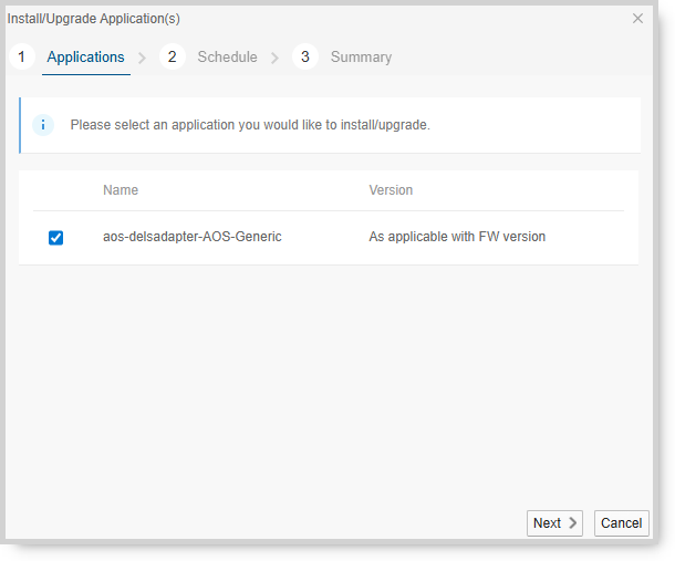

    Installing/Upgrading Application(s)
    The Install/Upgrade Applications(s) wizard is activated using the Install/Upgrade Application(s) button and allows administrators to apply software to a selected gateway via the following screens.
    Note:
    • This feature will not work with GX400, GX440, ES440, and LS300.
    • This feature is used for upgrading the aos-delsadapter application for AirLink OS routers. The AMM will automatically pick the appropriate application version based on the AirLink OS firmware version.
    Automatic AirLink OS Application Version Selection
    • There is no Operation created for application installs/upgrades.
    • If devices from multiple platforms are selected, the wizard will prompt you to choose only one platform at a time. Only the devices that run on the selected platform will be upgraded, as shown below.:
    Upgrade Applications Platform Selection
    Click on the checkbox beside the application that is to be applied to the gateways and select the version from the Version dropdown and click Next to continue.
    Note:
    • For AirLink OS routers, the correct AirLink OS application software will automatically be selected based on the firmware version of the gateway selected.
    Upgrade Applications - Selecting an Application for Upgrade
