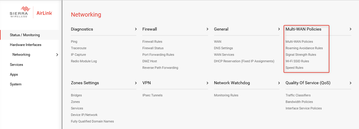

    WAN policies can be configured under Networking > Multi-WAN Policies.
